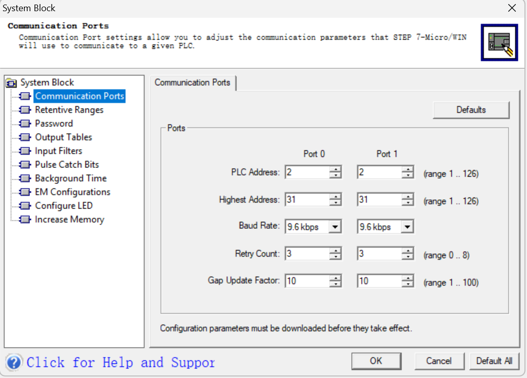

PLC Side: Simple Ladder logic where V0.0 triggers Q0.0. It works perfectly when forcing the bit via Micro/WIN Status Chart.

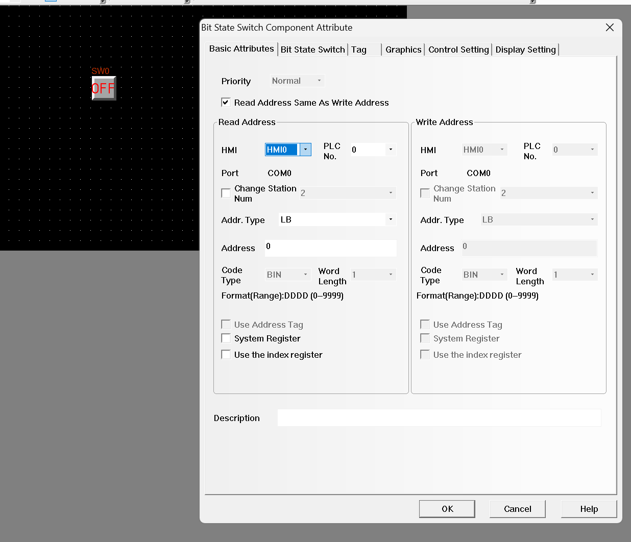

HMI Side: I configured a Bit Switch addressing V.B 0.0 using the Siemens S7-200 driver on COM0.
The Issue: The project downloads successfully to the HMI via USB, but there is no communication with the PLC. I am getting this specific error on the HMI screen:
[2] PLC NO RESPONSE 0-02-00

Parameters: Are there any specific baud rate (9.6k/19.2k) or parity settings that I should check in the PLC System Block to match the HMI settings?
